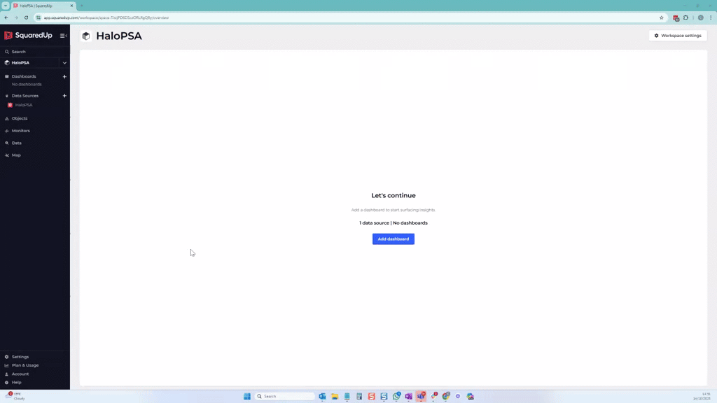

Configuring the data source
  1. Display name:
    Enter a name for your data source. This helps you to identify this data source in the list of your data sources.
  2. HaloPSA server URL:
    The address where your environment is located. You'll see this in the address bar of HaloPSA, usually in this format: https://yourcompany.halopsa.com
  3. Authentication:
    1. If you chose Client ID and Secret in HaloPSA, then select Client credentials in SquaredUp:
      1. Client id:
        Enter the Client id for the application you registered in HaloPSA.
      2. Client secret:
        Enter the Client secret for the application you registered in HaloPSA. If you forgot to save it, you can Generate it again in HaloPSA.
    2. If you chose Username & Password in HaloPSA, then select Basic in SquaredUp:
      1. Client id:
        Enter the Client id for the app you registered in HaloPSA.
      2. Username:
        Enter the username of your HaloPSA Agent (not the email address). This must be an Agent, not a User.
      3. Password:
        Enter the password for the Username you entered.
  4. Specific tenant:
    The tenant will be automatically extracted from the server URL (e.g. 'company1' from 'https://company1.halopsa.com'), but you can manually specify a tenant ID by checking this option and entering a tenant id in the box.
    The tenant can be found in HaloPSA from Configuration > Integrations > HaloPSA API
  5. Restrict access to this data source:
    Optionally, enable this toggle if you only want certain users/groups to have access to the data source, or those with the permission to link it to new workspaces. See data source access control for more information.
  6. Click Test and add to validate the data source configuration. SquaredUp will now attempt to connect using the provided authentication method.
    • Testing passed – a success message will be displayed and then the configuration will be saved.
    • Testing passed with warnings – warnings will be listed and potential fixes suggested. You can still use the data source with warnings. Select Save with warnings if you believe that you can still use the data source as required with the warnings listed. Alternatively, address the issues listed and then select Rerun tests to validate the data source configuration again. If the validation now passes, click Save.
    • Testing failed – errors will be listed and potential fixes suggested. You cannot use the data source with errors. You are able to select Save with errors if you believe that a system outside of SquaredUp is causing the error that you need to fix. Alternatively, address the issues listed and then select Rerun tests to validate the data source configuration again. If the validation now passes, click Save.
    You can edit data source configurations at any time from Settings > Data Sources.
